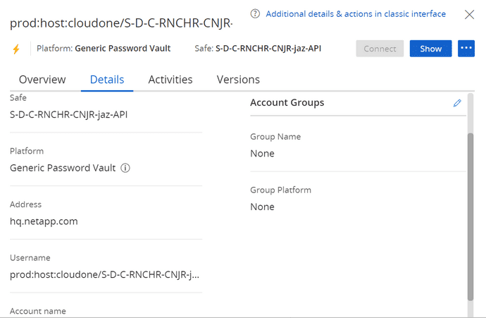

  1. CyberArk Safes will be automatically created during workspace provisioning. Login in to https://pvwa.corp.netapp.com/PasswordVault/v10/Accounts and retrieve the username and password of your Dev/Stg/Prod Safe from the API Safes - > eg: S-D-C-RNCHR-CNJR-< appcode >-api. Refer the below image.
    username
