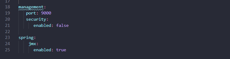

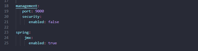

  2. For Spring Boot 2.2.x and later it's necessary to enable JMX in the application.properties
    spring.jmx.enabled=true
    or, in the application.yaml :
    springboot
