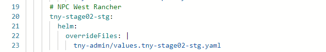

  • Add host space details in azure-pipeline.yml. edit-profile

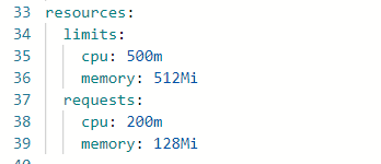

  • Check CPU & Memory status of micro-services in CloudOne and update your application's requirement in your values.yml file. edit-profile

      • This is only for cpuRequests , we are not restricting cpuLimits .
      • Minimum CPU request is 160 and default is also set to 160 .
